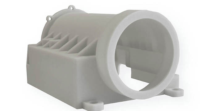

PA 12 Value is a sustainable and highly cost-effective material made from recycled powder. PA 12 Value offers high impact and temperature resistance, plus stability under a wide range of environmental conditions and near isotropic mechanical properties making it a great choice for functional and prototype parts.
Applications
PA 12 Value is often used to build housings, enclosures, and fixtures, and can work well for snap fits and hinges.
