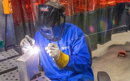

Welding Guidelines
Welding is available to join or fuse your metal components into their assembled form. Our most common welding capabilities include gas metal arc welding (MIG) and gas tungsten arc welding (TIG).
Welding Design Guidelines:
  • To avoid material warping or “oil canning,” the minimum material thickness for welded assemblies is 0.042 in. (1.07mm).
  • Maximum material thickness for welded assemblies is 0.250 in. (6.35mm).
  • Always specify welding location requirements on your 2D drawing.
  • If possible, avoid specifying a welding method, unless required for functionality.
  • Material types must be consistent across parts when welding multiple geometries.
Riveting is an option to consider if you are looking for additional flexibility when joining your metal components. Riveting is a technique in which components are joined using a type of hardware called a rivet. For more information, review our blog post on the different advantages of welding or riveting your next project.
Lead Time: Welding adds 1 business day.
Welding creates a strong bond between two pieces of sheet metal.
