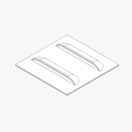

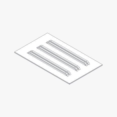

Stocked Bridge Lance Tools
A bridge lance feature is a raised, bridge-like structure formed by partially cutting and then bending the metal, which provides reinforcement, allows for airflow, or facilitates fastening without additional components. Click on the tabs below to see what features are stocked for available material thicknesses.
| Name | Station | Width | Length | Height |
| BL11 | B(1-1/4) | 0.25 | 0.72 | 0.2 |
| BL12 | B(1-1/4) | 0.079 | 0.437 | 0.118 |
| BL13 | B(1-1/4) | 0.154 | 0.669 | 0.157 |
| BL21 | B(1-1/4) | 0.118 | 0.542 | 0.173 |
| BL31 | B(1-1/4) | 0.125 | 0.275 | 0.173 |
| BL32 | B(1-1/4) | 0.15 | 0.58 | 0.13 |
| BL33 | B(1-1/4) | 0.25 | 0.285 (flat) | 0.071 (opening) |
| BL34 | B(1-1/4) | 0.125 | 0.526 | 0.188 |
| BL35 | B(1-1/4) | 0.276 | 0.737 | 0.157 |
| BL36 | B(1-1/4) | 0.157 | 0.583 | 0.138 |
| BL37 | C(2) | 0.394 | 1.348 | 0.197 |
| BL51 | B(1-1/4) | 0.075 | .361 Flat | 0.175 |

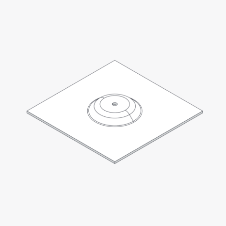

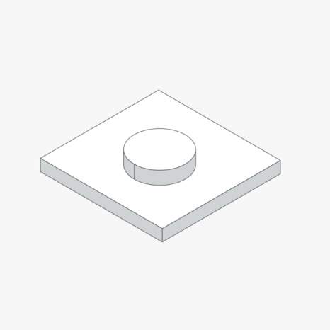

Stocked Dimple/Emboss Tools
An emboss feature is a raised or recessed design stamped into the material to add rigidity, create decorative elements, or provide functional enhancements such as grip or alignment features. A dimple feature is the same as an emboss feature, just at smaller dimensions.
Download dimple and emboss CAD files:
Emboss ToolsDimple Tools
Emboss Tools
| Name | Station | X-axis | Y-axis | Height |
| EB11 | B(1-1/4) | 0.5 | 0.563 | 0.089 |
| EB12 | C(2) | 1.56 | 0.69 | 0.067 |
| EB13 | C(2) | .375 Flat | 0.167 | |
| EB14 | B(1-1/4) | .210 Flat | .157 | |
| EB15 | C(2) | .983 Flat | .483 Flat | 0.2 |
| EB16 | B(1-1/4) | .54 Flat | 0.07 |
*if an emboss tool has an X dimension shown, it is a non-round feature (e.g. obround or square)

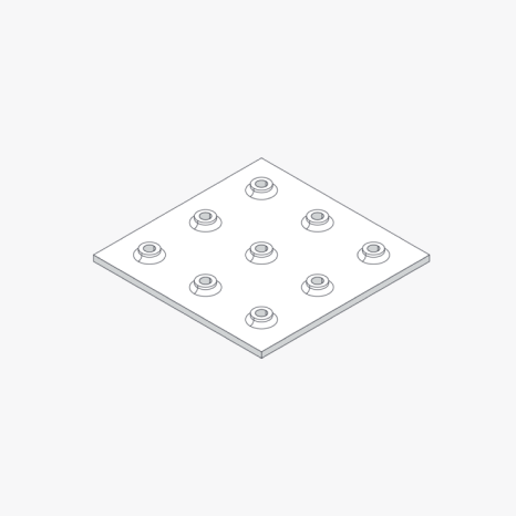

Dimple Tools
| Name | Station | Depth | Height |
| D11 | B(1-1/4) | 0.145 | 0.02 |
| D12 | B(1-1/4) | 0.456 | 0.096 |
| D13 | B(1-1/4) | 0.157 | 0.098 |
| D14 | B(1-1/4) | 0.153 | 0.026 |
| D41 | B(1-1/4) | .070 Flat | 0.03 |
| D42 | A(1/2) | 0.181 | 0.041 |
| Name | Station | Internal Diameter | Height |
| EX11 | B(1-1/4) | 0.098 | 0.036 |
| EX12 | B(1-1/4) | 0.130 | 0.039 |
| EX13 | B(1-1/4) | 0.087 | 0.04 |
| EX21 | B(1-1/4) | 0.136 | 0.082 |
| EX22 | B(1-14) | 0.106 | 0.053 |
| EX31 | B(1-1/4) | 0.145 | 0.136 |
| EX32 | B(1-1/4) | 0.283 | 0.14 |
| EX41 | B(1-1/4) | 0.213 | 0.083 |
| EX61 | B(1-1/4) | 0.236 | 0.102 |
| EX62 | B(1-1/4) | 0.22 | 0.106 |
| Name | Station | Diameter | Height |
| HS11 | B(1-1/4) | 0.059 | 0.018 |
| HS21 | B(1-1/4) | 0.188 | 0.03 |
| HS61 | B(1-1/4) | 0.157 | 0.052 |
| HS71 | B(1-1/4) | 0.236 | 0.06 |
| HS72 | B(1-1/4) | 0.055 | 0.06 |
| HS73 | B(1-1/4) | 0.228 | 0.06 |
| HS74 | B(1-1/4) | 0.25 | 0.06 |
| HS75 | B(1-1/4) | 0.163 | 0.06 |

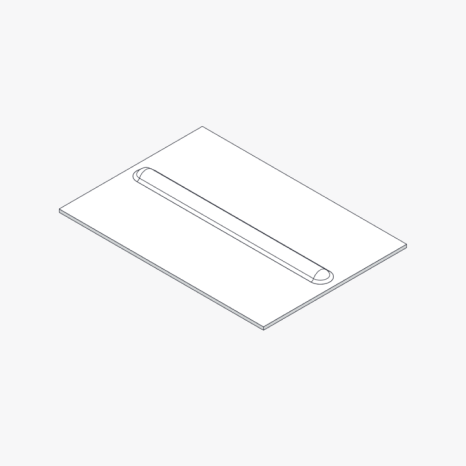

| R11 | B(1-1/4) | 0.207 | .438 min | 0.035 |
| R12 | B(1-1/4) | 0.246 | .425 min | 0.05 |
| R13 | B(1-1/4) | 0.375 | .700 min | 0.1 |
| R14 | B(1-1/4) | 0.246 | 0.746 | 0.059 |
| R15 | B(1-1/4) | 0.108 | .401 min | 0.04 |
| R21 | B(1-1/4) | 0.177 | .453 min | 0.039 |
| R22 | C(2) | 0.562 Flat | .900 min | 0.098 |
| R23 | B(1-1/4) | 0.457 | .700 min | 0.182 |
| R31 | B(1-1/4) | 0.182 | 0.407 min | 0.045 |
| R32 | B(1-1/4) | 0.482 | 0.700 min | 0.182 |
| R33 | B(1-1/4) | 0.135 | 0.4 | 0.03 |
| R34 | C(2) | 0.731 | 0.803 min | 0.126 |
| R35 | B(1-1/4) | 0.362 | 0.454 min | 0.059 |
| R41 | B(1-1/4) | 0.3 | 0.627 min | 0.135 |
| R42 | C(2) | 0.394 | 1.022 min | 0.201 |
| R51 | B(1-1/4) | 0.29 | .536 min | 0.079 |
| R52 | B(1-1/4) | 0.214 | .464 min | 0.062 |
| R53 | B(1-1/4) | 0.525 | .700 min | 0.182 |
| R71 | B(1-1/4) | 0.511 | .700 min | 0.187 |
