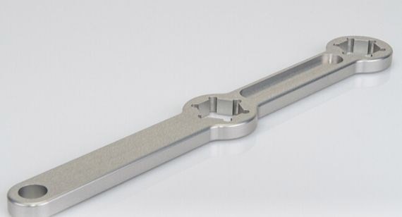

Long-life Finishes
The most common application used to help strengthen and or prevent corrosion on sheet metal parts is plating. Passivation is another, but in a different way that we’ll talk about in a second.
Plating is used to harden sheet metal parts and prevents corrosion by adding a thin layer of another metal, like chromate or zinc. Plating is most used with aluminum and may be particularly useful during field testing.
It’s worth mentioning that we do offer pre-plated steels such as galvanized and galvanneal that arrive from the mill pre-coated. We won’t apply additional coatings to parts made with those two materials, but we will deburr pre-plated parts after lasering. This removes the coating on the edges around the perimeter, cutouts, and holes. The remaining part profile will keep the coating. This could be a low-cost alternative.
Protolabs offers the following five plating options for sheet metal parts:
- Anodizing, to prevent scratches and dents and improve aesthetics
- Block oxide, to prevent corrosion and reduce light reflection
- Chromate, to minimize wear and friction and improve aesthetics
- Tin, to protect against water damage
- Zinc, to protect against water damage
Passivation is a cleaning process that limits corrosion and rust on stainless steel parts by removing or limiting traces of contamination caused by the presence of susceptible elements. Citric acid is used to remove these and basically wash them away. While it’s not a 100% perfect solution, it is recommended for all stainless steel sheet metal parts that must withstand extreme conditions.
