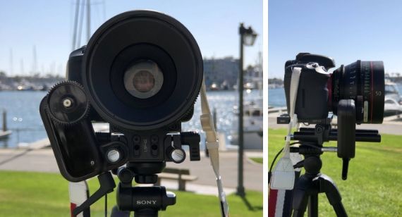

Our goal at Gravity Laboratories is to empower filmmakers to tell their story. We do this by designing high-quality products and making them available at an accessible price. Moxie is a wireless lens control system. It mounts to a camera lens, and allows the user to control focus, iris, and zoom via a smartphone or handheld controller. All the electronics are integrated directly into the device and it’s powerful enough to control even the stiffest lens.
