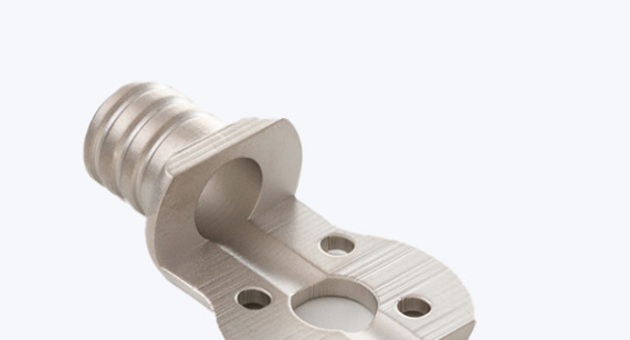

Threads don’t form well in 3D printing due to layering, tolerances, and over curing of the material. One option for improved thread performance is to have holes threaded or tapped after the build has been completed—this provides smooth threads and enhanced performance. Alternatively, threaded inserts can be installed to further improve strength. With stereolithography (SL), we install threaded inserts by gluing them in place and with selective laser sintering (SLS), we heat stake them in as SLS uses commercial-grade thermoplastic nylon.

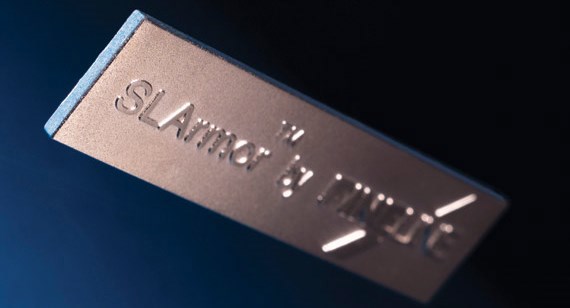

Metal Plated Ceramic (PerFORM) adds mechanical strength and durability to 3D-printed parts. This ceramic-filled nickel plating can be applied to eligible parts to enhance wear resistance, surface hardness, and dimensional stability. Another way to improve part performance is by applying Metal Plated Ceramic (PerFORM), a ceramic-filled nickel plating that increases durability, surface hardness, and thermal performance. Metal Plated Ceramic (PerFORM) can be selected in your ProtoQuote when you need parts to mimic the look and performance characteristics of die-cast aluminum, for example. Metal Plated Ceramic (PerFORM) is available with several surface finish options and can be applied at two thicknesses that influence part performance. Those thicknesses are approximately 0.002 in. and 0.004 in.

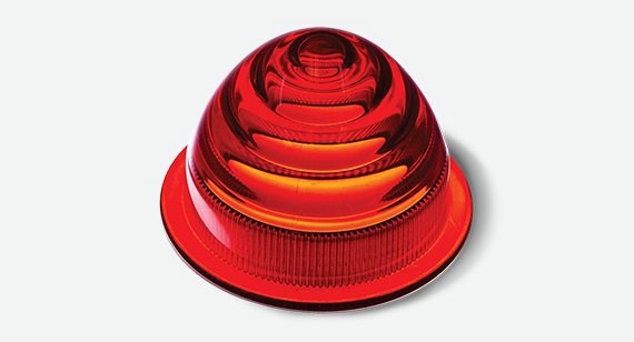

Color and cosmetic appearance options are limited as manufactured, but many times this often can be improved in post-production so that 3D-printed parts resemble injection-molded parts. We have a few different ways of altering part color, which include applying a colored dye, custom paint, or soft-touch paint to SL and SLS parts. A dye is generally going to be less expensive and faster than paint.
A  red, 3D-printed taillight lens
A transparent taillight lens was created with a red dye applied to clear SL part.
  • With part dyeing we offer five primary colors: black, red, yellow, blue, and green. Dyeing results in an opaque or transparent appearance depending on the base material.
