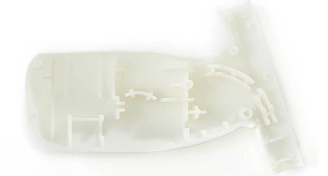

PC-like Ceramic-like (Advanced HighTemp PerFORM)
Ceramic-Like White (Advanced High Temp) combines superior high heat tolerance with strength and stiffness.
![3D Printed PC-like Ceramic-like (Advanced High Temp)](/media/k2zpl0qq/3dp-materials-tool_images_ceramic-like-advanced-hightemp-perform.jpg?width=670&height=360&rnd=133318977720400000)
Product Description
Ceramic-Like White (Advanced High Temp) combines superior high heat tolerance with strength and stiffness. A thermal post-cure can be used to further improve mechanical properties and its heat resistance, however, it will be more brittle.
Applications
Advanced Ceramic-Like High-Temp White is often used for automotive housings, electrical casings, wind tunnel testing, and other components that require high heat tolerance and strength.
Tolerances
For well-designed parts, tolerances in the X/Y dimension of ±0.002 in. (0.05mm) for the first inch plus ±0.001 in./in., and Z-dimension tolerances of ±0.005 in. (0.127mm) for the first inch plus ±0.001 in./in. (0.001mm/mm), can typically be achieved. Note that tolerances may change depending on part geometry.
