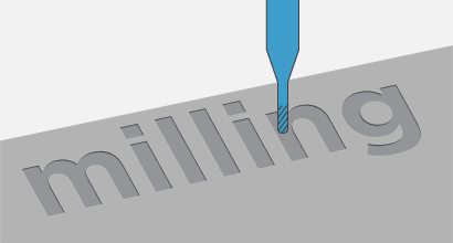

Text
Protolabs’ fully automated factory allows you to design in engraving.  Recommended text considerations for CNC milling:
  • Plastic and soft metals: Minimum width of 0.018 in. (0.457mm), depth of 0.0118 in. (0.3mm). Example text size would be 16 point Arial Rounded MT font.
  • Hard metals: Minimum width of 0.033 in. (0.838mm) and depth of 0.0118 in. (0.3mm). Example text size would be 22 point Arial Rounded MT font.
  • If design permits it, opt for recessed text versus raised.
Protolabs also offers Laser Part Marking and Ink Stamp for our semi-automated factory capability as well as via Protolabs Network website.
