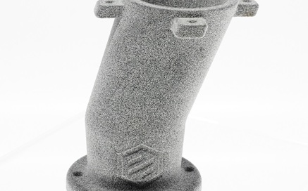

Thermoplastic polyurethane (TPU) is a flexible thermoplastic material that offers abrasion resistance, chemical resistance, impact strength, and overall toughness.
Our injection molding service offers two grades of TPU:
Texin 245D | Texin 983A |
TPU Material Properties
Flexural Modulus |
Abrasion Resistance |
Tensile Stress |
Tear Strength |
Tensile Elongation (Break) |
Test Method | ASTM D790 | ASTM D1044 | ASTM D412 | ISO 34-1 | ASTM D412 |
Texin 245D | 73F: 9,990 psi 158F: 7,500 psi |
70 mg | 50% strain: 1,100 psi 100% strain: 1,310 psi 300% strain: 3,000 psi |
700 lb/fin | 500% |
Texin 983A | -22F: 8,560 psi 73F: 3,900 psi |
30 mg | 100% strain: 798 psi 300% strain: 1,200 psi |
500 lb/fin | 670% |
