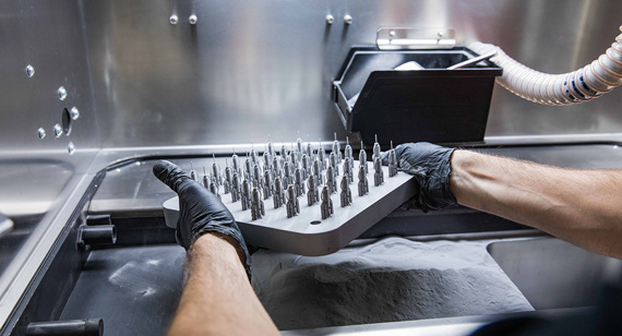

Metals and alloys can be suitable for medical applications, including those produced by Protolabs' 3D printing process direct metal laser sintering (DMLS).

Medical-Grade Metals and Alloys. Between machined and 3D-printed metals and alloys, plus sheet metal, there are more than 20 metal material options available for medical components, instrumentation, and other applications. Metal alloys like Inconel (a nickel-chromium superalloy) can be used in the 3D printing process direct metal laser sintering (DMLS), and have attributes like high-strength and temperature resistance while various stainless steel materials bring corrosion resistance and strength. Titanium is lightweight and temperature- and corrosion-resistant, and can also be used with DMLS to produce fully functional, 3D-printed medical components.
