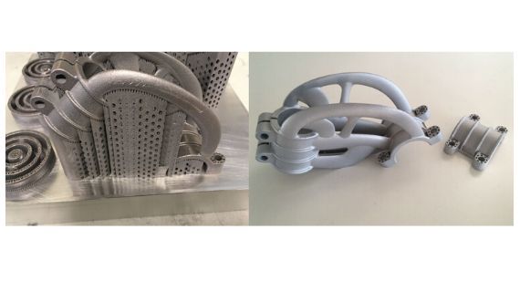

Some of you, and hopefully many, know that this is the furthest from the truth. Those less familiar may see AM as magic. Click start, go to lunch, and return to a finished product. Building high-quality polymer parts can take a lot of work, and metal parts can require significantly more. Much of the work can be in removing support material. Even more can involve finishing the surface, depending on what is required, and the solution used.
Building good AM parts starts with good design. Build orientation and nesting multiple parts in the build volume are also key. Both can have a considerable impact on the build time, where support material may be attached, and surface quality. Planning is key, but it can occur only after one has sufficient knowledge and experience so that the best decisions are made when designing and preparing parts for AM.
Additive manufacturing and 3D printing
3D-printed metal parts still welded to the build plate with support material (left), and finished parts after substantial post-processing (right). Photo courtesy of Olaf Diegel

This is the exception and not the rule. In other words, most parts made by AM require the removal of support material, finishing of the surface, and painting or adding a clear coat, in the case of polymer parts—all services available from Protolabs. While this is true most of the time, clips, brackets, and some other types of parts made in polymer require little post-processing time and effort. With the exception of cooling, and cleaning loose powder from them—in the case of powder bed fusion (PBF)—they are ready to use with little post-processing.
Metal parts can require many post-processing steps, which can increase time and cost. Depending on the application and specific requirements, metal parts made by PBF can involve: 1) removal of excess powder and safely transferring it to another location, 2) thermal stress relief to reduce the possibility of warping, 3) cutting parts from the build plate using wire EDM or a band saw, 4) hot isostatic pressing to eliminate porosity in the parts, 5) removal of support structures used to anchor the part and its features to the build plate, 6) additional heat treatment, 7) surface treatment such as shot peening and CNC machining, and 8) inspection and quality assurance.

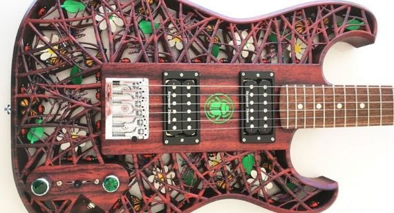

Most often, AM is used to produce an element of a product rather than an entire, completely functional product. Consider eyewear, footwear, and sporting goods, as well as parts for aircraft, automobiles, and machines. Parts made by AM contribute greatly to the product, but many other parts are made conventionally and assembled.
The main body of this guitar was 3D printed, but much of the remainder of the instrument was made using conventional manufacturing methods. Photo courtesy of Olaf Diegel

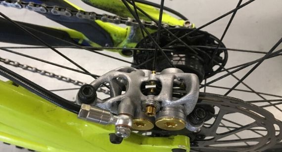

3D-printed bike brake caliper
This mountain bike brake caliper is 3D printed. Photo courtesy of Radic Performance

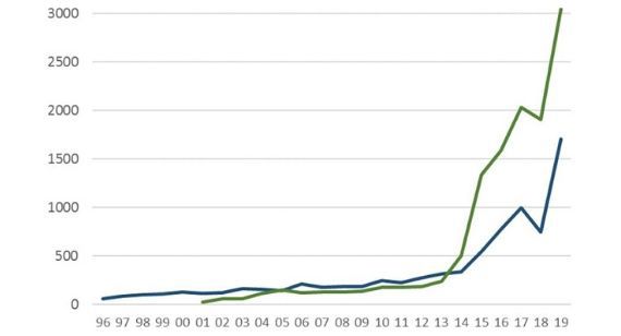

Wohlers table chart of AM-related patents
Growth of issued AM-related patents (in green) and AM-related published patent applications (in blue). Sources: Wohlers Report 2020; Finnegan, Henderson, Farabow, Garrett & Dunner; and the U.S. Patent and Trademark Office.

8. Most AM Inventions Occurred Years Ago
With the AM industry 32 years of age, one might assume that most inventions related to AM occurred many years ago. Far more have occurred in recent years than in the industry’s first 25 years, combined. To illustrate, Wohlers Report 2020 includes information on more than 200 manufacturers of industrial AM systems that were produced and sold machines last year. Not all include original IP, but many do.
