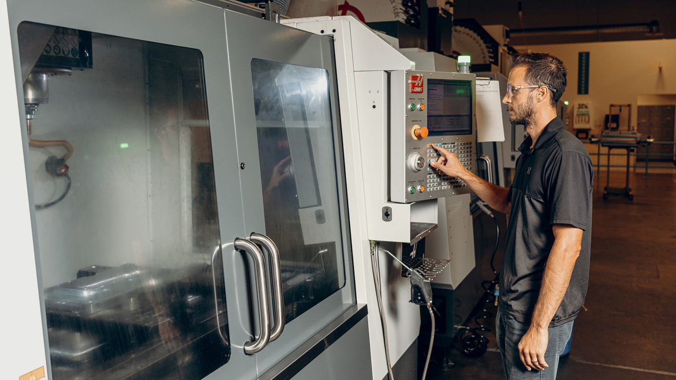

How Does G Code Work?
A CNC program is made up of lines, or blocks, of instructions. Each block tells the machine to perform one or a series of actions. The CNC controller reads those instructions and turns them into machine actions, coordinating axis movement, spindle operation, and other functions as the program runs.
  • Tool movement: Coordinates such as X, Y, and Z tell the machine where to position the tool, while commands determine whether it travels in a straight line, follows an arc, or rapidly repositions between cuts.
  • Feed rate: The program controls how quickly the tool moves through the material during cutting. The right rate depends on factors such as the material, tool, and type of operation.
  • Spindle speed: Instructions control how fast the spindle rotates and when it starts, stops, or changes direction.
  • Tool changes: When a part needs more than one cutting tool, the program tells the machine when to switch tools and which one to use next.

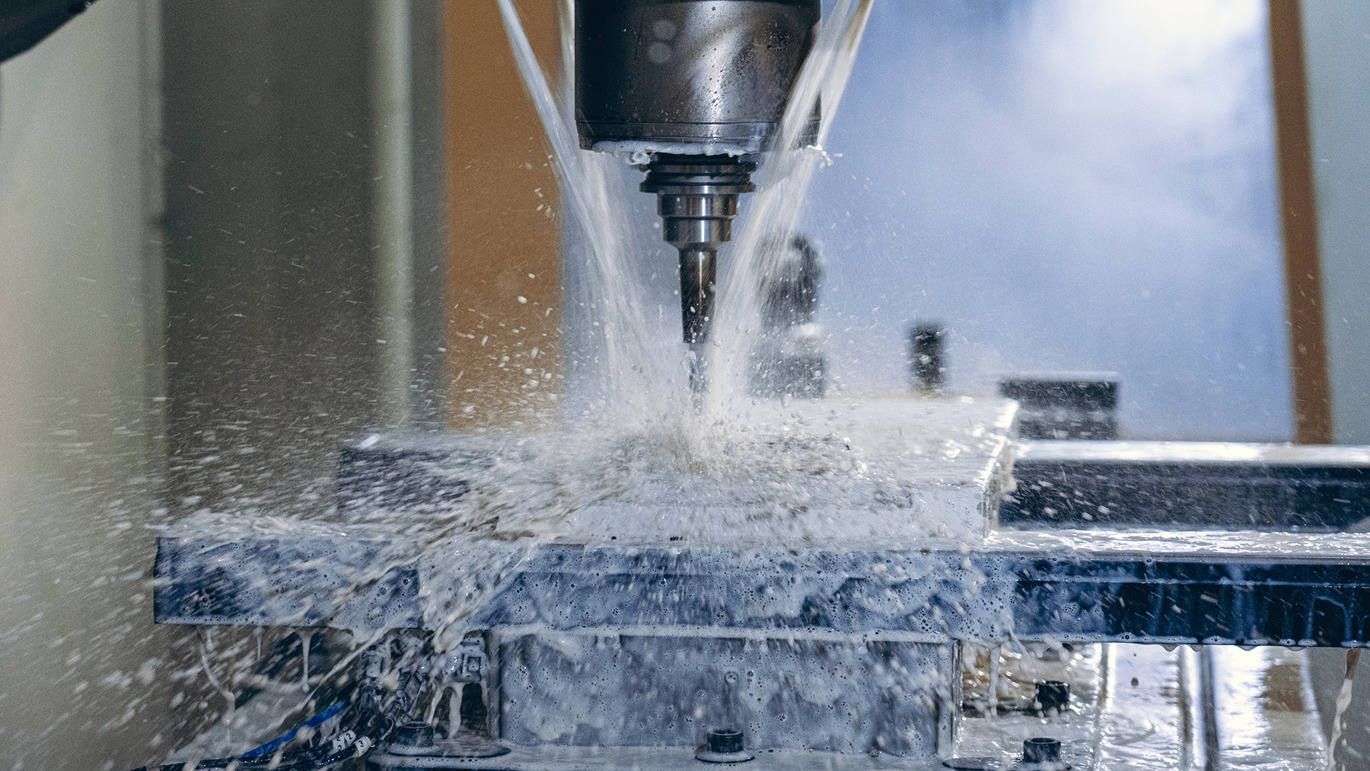

Designing Parts That Are Easier to Machine
You may never touch the G code yourself, but your design still has a big impact on how the part gets machined. Every pocket, hole, wall, radius, and surface can affect the project's budget and timeline.
That’s where design for manufacturability (DFM) can help.
There are several ways to optimize part design for CNC machining so the resulting toolpaths—and the G code behind them—can be simpler and more efficient. In practice, that often comes down to a few design choices:
  • Keep features easy to reach: Tall walls and hard-to-reach surfaces may need longer tools, extra setups, or more complicated tool movements. Find out more about how to CNC machine complex parts
  • Don’t make features deeper than they need to be: Deep pockets and holes usually mean more cutting passes and can make chip removal and tool rigidity harder to manage.
  • Give internal corners some radius: Very small radii need smaller cutting tools, which often means slower machining and more passes.
  • Use tight tolerances selectively: Fine-tuning tolerances for CNC machined parts is a balancing act. Tighter requirements can mean slower finishing passes or extra setups, so use them where fit and function justify the added precision.
  • Make setups and tool changes easier to avoid: If several features can be machined from the same orientation, or with compatible tool sizes, the overall machining strategy can be simpler and faster.
