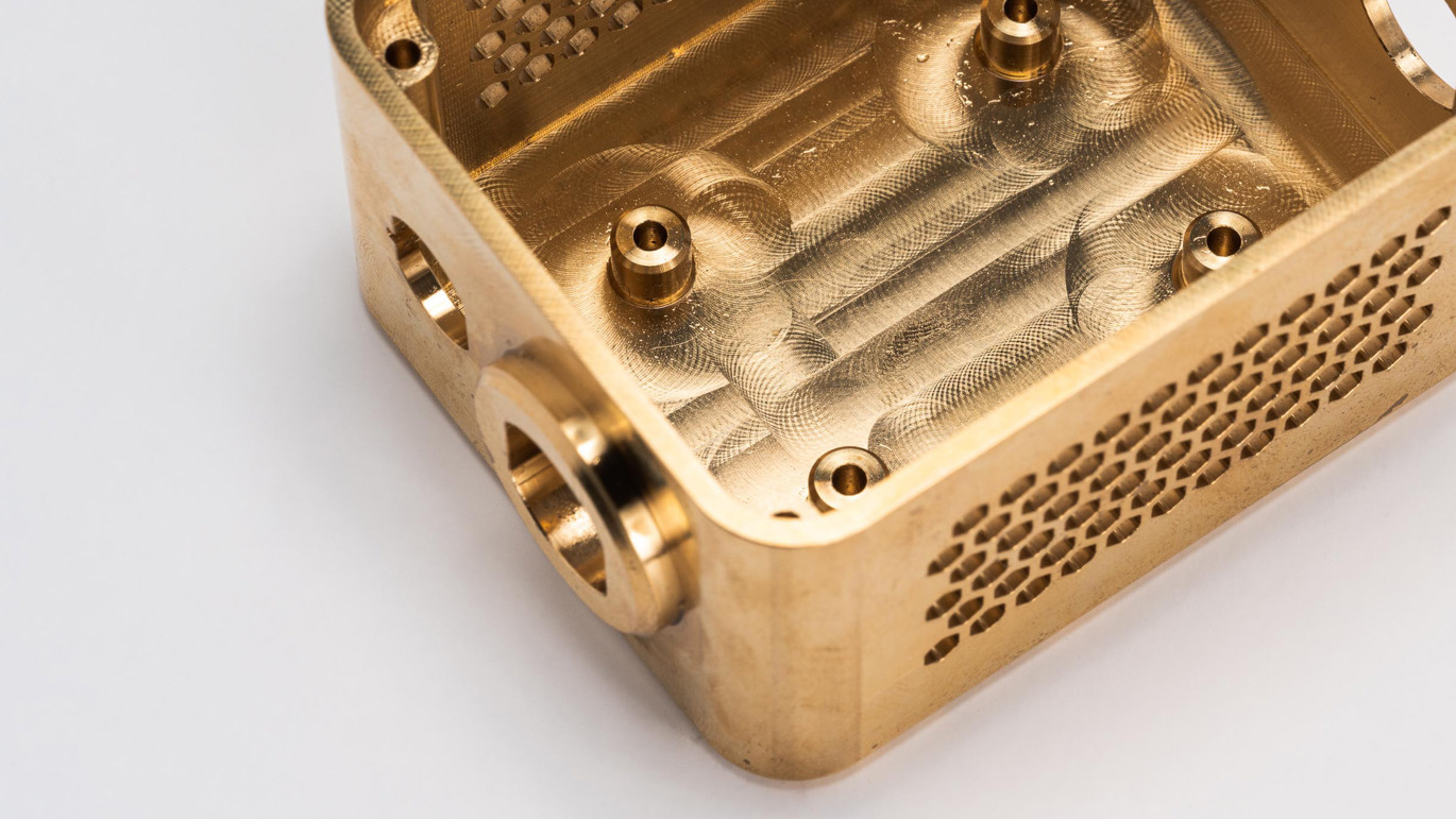

Brass for Automotive Parts
Brass is a copper-zinc alloy known for excellent machinability, corrosion resistance, and electrical conductivity. While it is not typically used for high-load structural components, it performs well in fluid handling and electrical applications.
Advantages of Brass
One of brass’s biggest advantages is its machinability. Engineers can produce complex geometries, threaded features, and tight-tolerance components with relatively low tool wear and fast cycle times.
Brass also resists corrosion in moist environments, making it suitable for automotive systems exposed to fluids or road conditions.
Additional advantages include:
  • Good thermal and electrical conductivity
  • Low friction characteristics
  • Attractive surface finish
  • Reliable sealing performance for fittings and valves
Common Automotive Uses for Brass
Brass is commonly used for:
  • Fuel line fittings
  • Sensor housings
  • Hydraulic connectors
  • Valve components
  • Battery terminals
  • Electrical connectors
For rapid development of custom brass components, manufacturers often use precision CNC machining services to support fast iteration and low-volume production.
Limitations of Brass
Despite its advantages, brass has lower tensile strength compared to steel and stainless steel. It may also deform more easily under high mechanical loads or elevated temperatures. For structural or high-stress applications, stronger ferrous metals might be preferred.

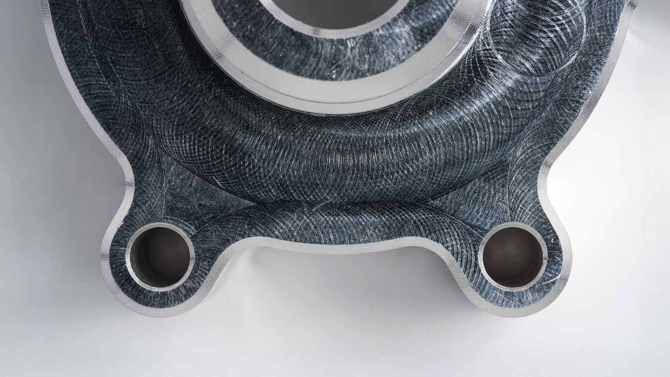

Carbon Steel for Automotive Parts
Carbon steel remains one of the most widely used materials in automotive manufacturing because of its strength, durability, and relatively low cost. Different carbon steel grades offer varying balances of hardness, toughness, and machinability depending on carbon content and heat treatment requirements.
Advantages of Carbon Steel
Carbon steel provides excellent mechanical strength and wear resistance, making it suitable for structural and load-bearing components.
Compared to stainless steel, carbon steel is often more cost effective and easier to machine in many applications.
Benefits include:
  • High tensile strength
  • Good fatigue resistance
  • Broad material availability
  • Lower raw material cost
  • Strong performance under mechanical stress
Common Automotive Uses for Carbon Steel
Automotive manufacturers frequently use carbon steel for:
  • Mounting brackets
  • Chassis components
  • Shafts and axles
  • Gears
  • Suspension hardware
  • Structural reinforcements
For production-grade metal components, processes such as sheet metal fabrication and CNC machining help support both prototype and end-use automotive parts.
Limitations of Carbon Steel
The primary drawback of carbon steel is corrosion susceptibility. Without coatings, plating, or protective finishes, carbon steel can rust when exposed to moisture, road salt, or chemicals. This makes surface treatment an important design consideration for automotive environments. Read more about corrosion resistance.
Carbon Steel
