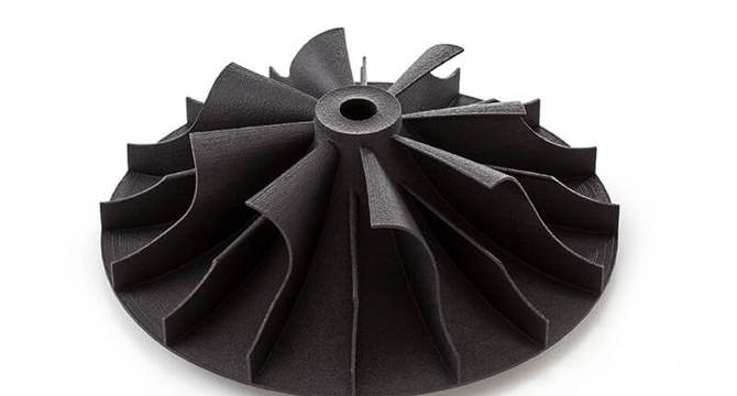

PA 12 40% Glass-Filled Black
A slightly less durable material that offers significant heat deflection.

PA 12 40% Glass-Filled Black is a 40% glass-filled nylon. Final parts are dyed black. The biggest advantage offered by this material is the heat deflection temperature of 248°F when measured at 264 psi, ranking 2nd best after PA 12 Mineral-Filled.
