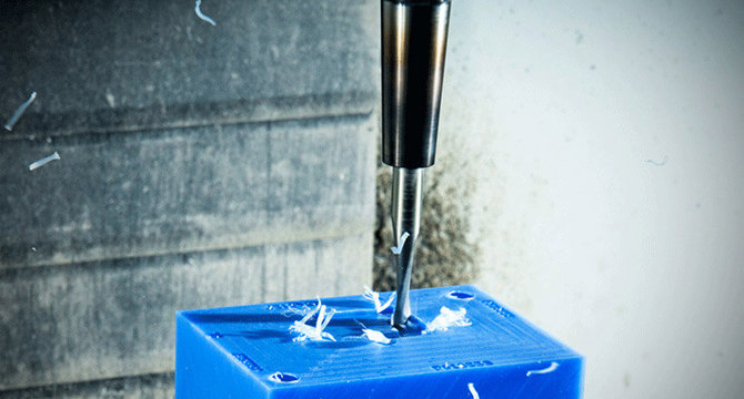

![cnc machining process](/media/1011669/web-cnc-dg-materials-milling-tiny.jpg?width=670&height=360&rnd=132871668174730000)
Design Guidelines
Ensure that your features allow for easy release of chips to avoid clogging your mills and burning material. Tight radii and sharp corners can cause stress and cracking and should be avoided. Using fillets and smooth transitions will improve your HIPS parts.
