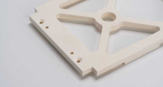

POM Plastic: Key Benefits and Applications
POM is a stiff, low-friction engineering plastic built for precise machined and molded parts.
POM
What is POM?
Polyoxymethylene (POM), also called acetal or polyacetal, is a stiff, low-friction engineering plastic that maintains dimensional stability over time. It resists wear, machines cleanly, and is often used for gears, bushings, bearings, and other parts that require reliable, repeatable performance.
POM comes in two main types:
  • POM-H (homopolymer acetal): Often referred to as Delrin, this grade offers higher stiffness, tensile strength, and fatigue resistance. Learn more about how Delrin can replace metal in some applications.
  • POM-C (copolymer acetal): Slightly lower in strength, but better at handling chemicals and processing heat. It also has no centerline porosity, which can make it a better choice for thicker cross-sections.
In practice, engineers often use acetal to mean POM-C and Delrin to mean POM-H, even though both are technically acetals.
