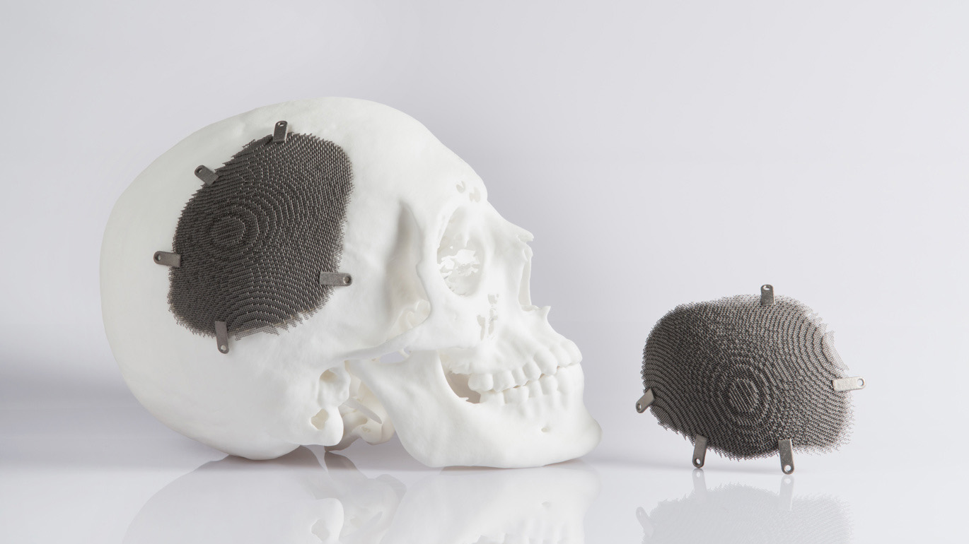

What Are 3D-Printed Anatomical Models?
3D-printed anatomical models are physical representations of patient anatomy created from medical imaging data such as CT or MRI scans. Specialized software converts imaging files into printable 3D geometry, which is then manufactured using additive manufacturing technologies including stereolithography (SLA), selective laser sintering (SLS), Multi Jet Fusion (MJF), and PolyJet printing.
Unlike generic anatomical references, these models can replicate patient-specific structures with a high degree of accuracy. Depending on the application, models may represent bone, vascular systems, organs, or soft tissue structures.
