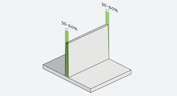

- One exception: ribs should be about 50-60 percent of the thickness of the main base, as shown in the photo to the right. Ribs that are the same thickness throughout can leave extra material at the base of the rib.

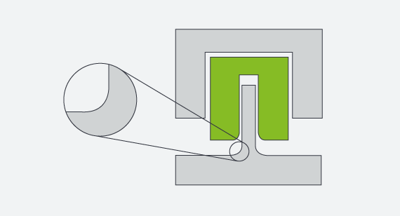

![Adding radii to internal corners of your part geometry is critical in helping a part eject cleanly from the mold.](/media/5ixf4ixp/blog_thin_wall_im_03-radii.png)
