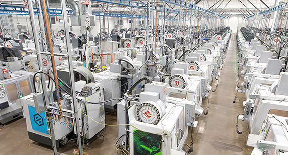

Machining facility at Protolabs
Our massive machining capacity, which can mill or turn parts in as fast as a day for rapid prototyping, can also be used for low-volume, end-use part production.
Machining for Higher-Volume Needs Emerges
At Protolabs, we saw a way to fill that production-quantity gap, and also solve the upfront- and warehousing-cost issues. Our massive machining capacity—with nearly 500 CNC machines—which can mill or turn parts in as fast as a day for rapid prototyping, could also be used for low-volume, end-use part production—this brings down machining costs without adding to lead time.

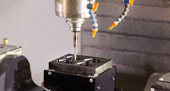

Machining for plastic end-use parts
Depending on volumes, machining plastics can be less expensive than other production methods.
Production Machining of Plastics
At volumes of a thousand or fewer, machining plastics can be less expensive than injection molding. In addition, machining can produce parts that would be difficult to mold. These can include parts with uneven wall thicknesses or with wall thicknesses over 0.150 in. (3.81mm), often needed for parts used as fixtures or wear plates.
The overall speed advantage of machining versus injection molding at modest production volumes increases as parts increase in size. In addition, machining plastic eliminates the risks of sink, warp, and knit lines that can occur in molded parts, and machined parts don’t require draft as injection-molded parts do.
In some cases, engineers might consider 3D printing for these production volumes, but the fact that machined parts are cut from solid billet gives them several advantages over 3D-printed parts. Because they aren’t layered, machined parts may have greater physical integrity than printed parts have. They can be cut from materials that cannot be used by 3D printers, and they can be machined to smoother finishes than printed parts.

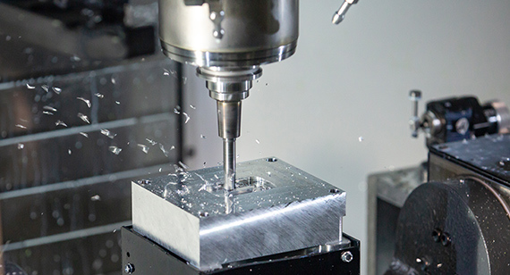

Machining of metal parts can be used for prototyping and end-use production.
Machining for production of end-use metal parts provides reduced costs and quick turnaround times.
Production Machining of Metal
At low- to medium-production volumes, machining of end-use metal parts offers significant advantages over die casting. As with plastics, at appropriate volumes, machining is faster and less expensive than casting.
While machining can begin turning out parts immediately, die casting requires the production of hardened steel tooling, which is a slow and costly process.
There are more metals that can be machined than can be die cast. And die casting leaves a rough surface like that found on cast iron cookware. Such surfaces can be smoothed by machining, but this is a time-consuming secondary process.
Die casting also does not produce as solid a finished product as the billet stock used in machining. Die cast metal can be porous, brittle, and subject to elongation. For these reasons, machining may still be preferable to casting even when casting has a cost advantage.
