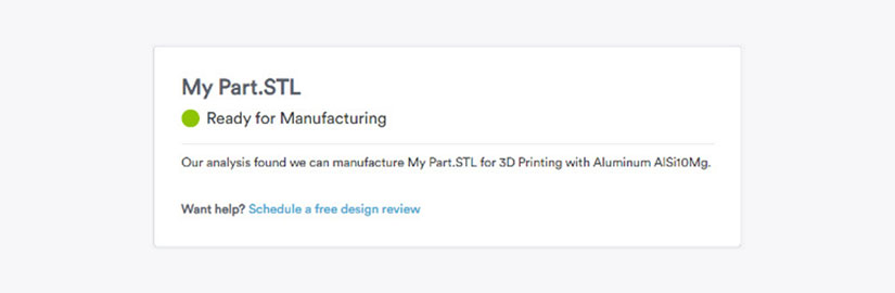

Additional Resources
If you need further assistance the following resources are available:
- Talk to your account manager about setting up a design review with one of our applications engineers.
- Set up a design review with an applications engineer directly using the link in your quote’s manufacturing analysis.
![](/media/aspj1wuy/design-review.jpg)
- Email us at [email protected].
- Call us at 877-479-3680 and follow the phone menu to speak with an applications engineer.
