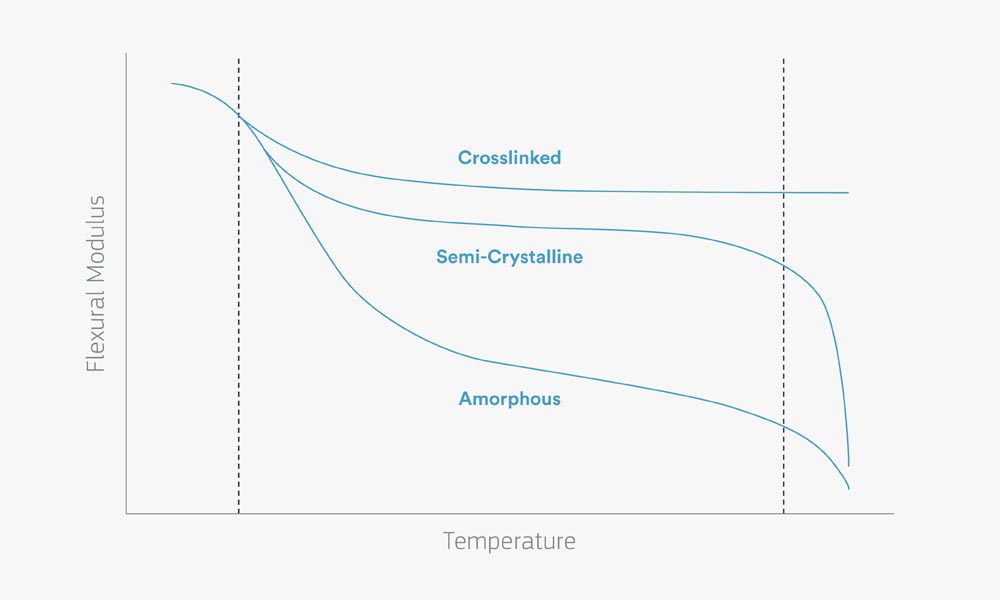

Glass transition temperature is the temperature at which an amorphous polymer changes from a hard/glassy state to a soft/leathery state, or vice versa. Tg is directly related to a material’s strength and capabilities in any given end-use application. Glass transition temperature is tied to a polymer’s mechanical properties. This includes its tensile strength, impact resistance, modulus of elasticity, and its operational temperature range, as you can see in figure 1.
Glass Transition Temperature (Tg) Chart
Figure 1: Flexural Modulus vs. Temperature
