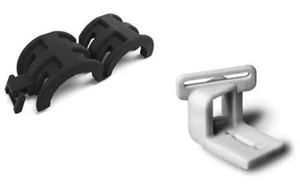

Multi Jet Fusion is an industrial 3D printing process that produces functional nylon prototypes and end-use production parts in as fast as 1 day. Final parts exhibit quality surface finishes, fine feature resolution, and ‬more consistent mechanical properties when compared to processes like selective laser sintering.
Common applications for Multi Jet Fusion are:
  • parts requiring consistent isotropic mechanical properties
  • functional prototypes and end-use parts
  • complex and organic geometries with fine features

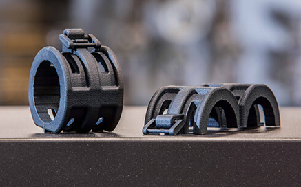

PA 12 Black
PA 12 Black is a high tensile strength nylon. Final parts are dyed black, and they exhibit quality surface finishes and slightly more isotropic mechanical properties when compared to SLS. When more detail is required, PA 12 can achieve smaller minimum feature resolution (0.02 in) as compared to SLS materials (0.03 in). PA 12 Black is the best material option for designs that incorporate living hinges.
Primary Benefits​
  • Near isotropic mechanical properties
  • Economical material choice
